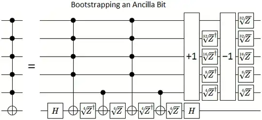

1. Bootstrap a Borrowable Ancilla Bit
Use a square root and its inverse to reduce the maximum number of controls by one, creating an uninvolved wire for each operation. Then iteratively move controls off of non-Not operations, and re-arrange the cruft that results into large increment gates and single-qubit phase gates.
Bootstrapping an Ancilla Bit

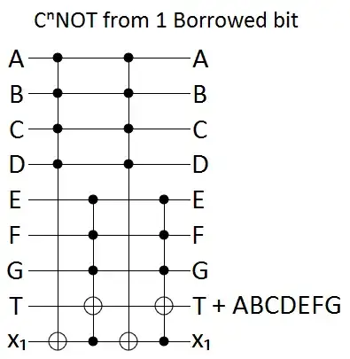

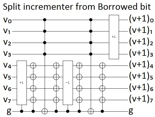

2. Use Single Ancilla Bit to Cut Operations in Half
For each large operation, use the uninvolved wire as a borrowed ancilla bit. Use it to transform the huge increment and controlled-not gates into smaller operations that each have approximately half of the wires uninvolved. Repeat twice, if required for the next step to have enough working space.
Halving Size of Controlled-Not with Ancilla
Halving Size of Incrementer with Ancilla

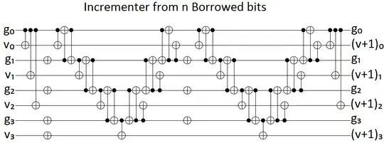

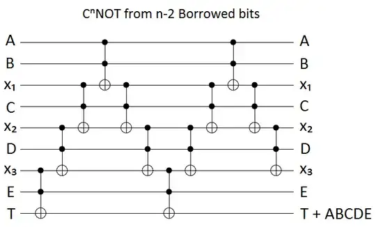

3. Use Many Ancilla Bits to Finish
For each still-too-large operation, borrow the many uninvolved wires as ancilla bits. Use them to get all the way down to Toffoli-or-smaller gates.
Reducing Controlled-Not to Toffolis
Reducing Incrementer to Toffolis
