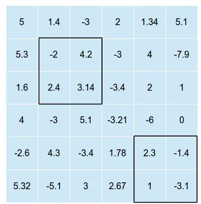

We have a two dimensional array/grid of numbers, each representing some "benefit" or "profit." We also have two fixed integers $w$ and $h$ (for "width" and "height".) And a fixed integer $n$.
We now wish to overlay $n$ rectangles of dimensions $w \times h$ on the grid such that the total sum of the values of cells in these rectangles is maximized.
The following picture is an example of a two-dimensional grid with two such rectangles overlayed on it (the picture does not demonstrate the optimal solution, just one possible overlaying where $w = h = 2$ and $n = 2$)
Grid example
The rectangles cannot intersect (otherwise we would just need to find the optimal position for one rectangle and then put all the rectangles in that position.)
In the example above the total sum of values in cells would be $-2 + 4.2 + 2.4 + 3.14 + 2.3 -1.4 + 1 - 3.1$
