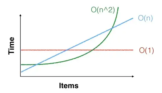

Here's a visual way to think about it.
All have a startup constant which determines their starting point on the Y axis. Each also has a critical constant $C$ dominating how fast they will increase.
  • For $O(1)$, $C$ determines the time.
  • $O(n)$ is really $C \times n$, where $C$ determines the angle.
  • $O(n^2)$ is really $(C \times n)^2$, where $C$ determines the sharpness of the curve.
To determine which algorithm you should use, you need to estimate the spot where the runtimes intersect. For example, an $O(1)$ solution with a high startup time or a high $C$ will lose to an $O(n)$ solution with a low startup time and a low $C$ at fairly large numbers of items.
