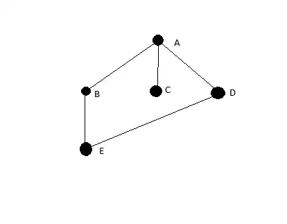

No, this is not the same as a DFS.
Consider the graph
If you push the nodes in right to left order, the algorithm gives you a traversal:
$A, B , E, C , D$
while a DFS would expect it to be
$A,B,E,D,C$
The problem occurs because you mark it as seen at the time of pushing, rather than at the time of visiting. As pointed out in the comments, if you mark at the time of visiting, your space requirements might go up to $\Theta(V+E)$ rather than $\mathcal{O}(V)$.
