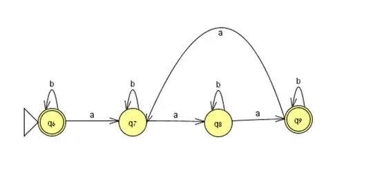

We need that the number of $a$'s will be only multiple of $3$, e.g words like $aaa,baaab,bababa,bbbbaaaaaa,\dots$ ets, so we will put the accept state on place such that the number of $a$'s $\mod(3)=0$ e.g $0\mod(3)=0,3\mod(3)=0,6\mod(3)=0,\dots$
Try this DFA:enter image description here
