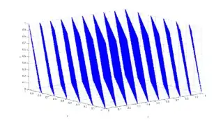

There is a whole class of algorithms that is inherently hard to test: pseudo-random number generators. You can not test a single output but have to investigate (many) series of outputs with means of statistics. Depending on what and how you test you may well miss non-random characteristics.
One famous case where things went horribly wrong is RANDU. It passed the scrutiny available at the time -- which failed to consider the behaviour of tuples of subsequent outputs. Already triples show lots of structure:
Basically, the tests did not cover all use cases: while single-dimensional use of RANDU was (probably mostly) fine, it did not support using it to sample three-dimensional points (in this way).
Proper pseudo-random sampling is a tricky business. Luckily, there are powerful test suites there days, e.g. dieharder that specialise in throwing all the statistics we know at a proposed generator. Is it enough?
To be fair, I have no idea what you can feasibly prove for PRNGs.
