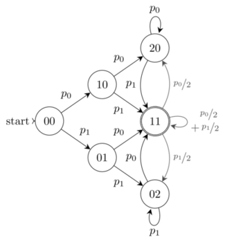

For $N=2$ the resulting Markov chain¹ is
Markov chain for N=2
[source]
with expected number of steps until absorption

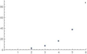

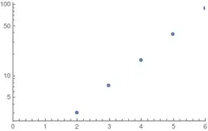

For $N \leq 6$ and uniform distributions (the best case) I have performed the calculations with computer algebra²; since the state space explodes quickly, larger values are hard to evaluate. The results (rounded upwards) are
NormalPlot LogPlot
Plots show $\mathbb{E}\,\text{steps}$ as a function of $N$; to the left a regular and to the right a logarithmic plot.
The growth seems to be exponential but the values are too small to give good estimates.

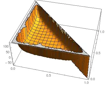

As for stability against perturbations of the $p_i$ we can look at the situation for $N=3$:
Expected number of steps for N=3 and different choices
Plot shows $\mathbb{E}\,\text{steps}$ as a function of $p_0$ and $p_1$; naturally, $p_2 = 1 - p_0 - p_1$.
Assuming similar pictures for larger $N$ (kernel crashes computing symbolic results even for $N=4$), the expected number of steps seems to be quite stable for all but the most extreme choices (almost all or none mass at some $p_i$).

  1. Since the chain is absorbing in $(11)$ the edges hinted at in gray are never traversed and do not influence the calculations. I include them merely for completeness and illustrative purposes.
