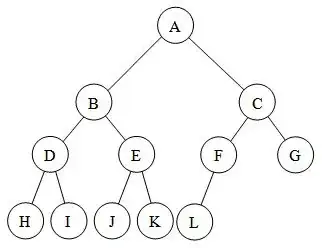

Minimum height = $h_{min}=\lceil \log_2{(n+1)}\rceil-1=\Theta(\log(n))=O(\log(n))$
which happens in the case of complete binary search tree as below if all levels contains all elements except last level (Last level may be not contain all elements).
Now, number of comparisons $= h_{min}+1=\lceil \log_2{(n+1)}\rceil=\Theta(\log(n))=\ O(\log_2(n))$
Which may be the tightest upper bound you are asking for .
