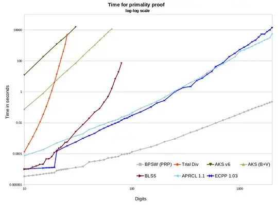

Measured primality times

In the graph, we see two open source AKS implementations -- the first being from the v6 paper, the second including improvements from Bernstein and Voloch and a nice r/s heuristic from Bornemann. These use binary segmentation in GMP for the polynomial multiplies so are pretty efficient, and memory use is a non-issue for the sizes considered here. They produce nice straight lines with a slope of ~6.4 on the log-log graph, which is great. But extrapolating out to 1000 digits arrives at estimated times in the hundreds of thousands to millions of years, vs. a few minutes for APR-CL and ECPP. There are further optimizations which could be done from the 2002 Bernstein paper, but I don't think this will materially change the situation (though until implemented this isn't proven).
Eventually AKS beats trial division. The BLS75 theorem 5 (e.g. n-1 proof) method requires partial factoring of n-1. This works great at small sizes, and also when we're lucky and n-1 is easy to factor, but eventually we'll get stuck having to factor some large semi-prime. There are more efficient implementations, but it really doesn't scale past 100 digits regardless. We can see that AKS will pass this method. So if you asked the question in 1975 (and had the AKS algorithm back then) we could calculate the crossover for where AKS was the most practical algorithm. But by the late 1980s, APR-CL and other cyclotomic methods was the correct comparison, and by the mid 1990s we'd have to include ECPP.
The APR-CL and ECPP methods are both open source implementations. Primo (free but not open source ECPP) will be faster for larger digit sizes and I'm sure has a nicer curve (I haven't done new benchmarking yet). APR-CL is non-polynomial but the exponent has a factor $\log \log \log n$ which as someone quipped "goes to infinity but has never been observed to do so". This leads us to believe that in theory the lines would not cross for any value of n where AKS would finish before our sun burned out. ECPP is a Las Vegas algorithm, in that when we get an answer it is 100% correct, we expect a result in conjectured $O(\log^{5+\epsilon}(n))$ (ECPP) or $O(\log^{4+\epsilon}(n))$ ("fastECPP") time, but there may be numbers that take longer. So our expectation is that standard AKS will always be slower than ECPP for almost all numbers (it certainly has shown itself so for numbers up to 25k digits).
