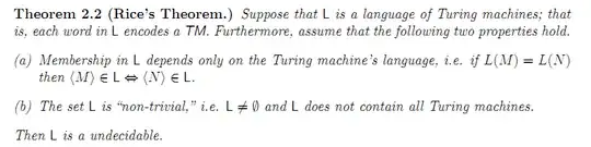

I think I got it. Here is Rice's Theorem (Rice Theorem and Turing machine b ehavior prop erties):
Rice's Theorem

That answers why I only need one string w and reduced x from w to prove a language L with property P is undecidable.
According to Rice's Theorem, if language L with property P has Turing Machines that does not accept language of L, L is undecidable. Thus:
$$L_{p} = \{ L(M_{0}), L(M_{1}), L(M_{2}),..., L(M_{n})\}$$ $$L'_{NotInp} = \{ L(M_{0}), L(M_{1}), L(M_{2}),..., L(M_{n}) \}$$
$$M_{i}\mspace{8mu} \text{is}\mspace{8mu} \text{an}\mspace{8mu} i\text{th}\mspace{8mu} \text{Turing} \mspace{8mu} \text{machine},\mspace{8mu} i ≤ n. $$
If the language L' (which contains TMs not in P) is not an empty set, the above L sub P is undecidable. Recall that language with property P is decidable if and only if it is trivial, which means either it contains every RE languages or not at all. Since if a language L with property P is decidable, every Turing Machines accept every string in L, so we don't need to test the acceptance of input to a given TM.
Also, according to the definition of a problem in the context of Turing Machine, if we have the answer (an algorithm) to every instance of the language L sub P (obviously, since L sub P contains every TM), L sub P is decidable. Otherwise, it's not.
