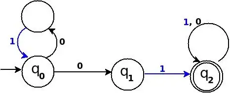

Yes, you are correct computers are deterministic automate. Non-deterministic models are more useful for theoretical purpose, sometime the deterministic solution is not as obvious to the definition(or say problem statement) and so little hard to find solution. Then one approach is that first design a non-deterministic model that may be comparatively easy to design and then try to convert it into a deterministic one. Below, I have tried to demonstrate what I mean with an example. Consider regular expression:
(01)*01(0 + 1)*
Now suppose, if you are asked to draw DFA for the language generated by above RE.
With my knowledge of designing FAs, I know that (1) when a * present in regular expression indicated I need corresponding loop in FA (2) concatenate operations like a.b means something like: (q0)─a→(q1)─b→(q2).
So, at my fist attempt I would draw an NFA like:
fig
Thought this is not a deterministic solution but looks very simple FA that can be easily designed using the given regular expression. My kind-of-analogy to show similarity between the above regular expression and my NFA is as below:
  1. The loop at state q0 should be for (01)*
  2. 01 (after (01)*) gives (q0)─0→(q1)─1→(q2)
  3. (0 + 1)* gives a self loop at state q2 for label 0, 1
According to my analogy I think the FA I drawn above is comparatively simple to draw from given RE. And luckily in class of finite automata every Non-deterministic model can be converted into an equivalent deterministic one. We have algorithmic method to convert an NFA into DFA. So I can easily convert above NFA into a DFA:
