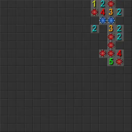

This is an example of scores having been applied to Minesweeper Flags. This is the map that was scored:
Minesweeper Flags map that was scored

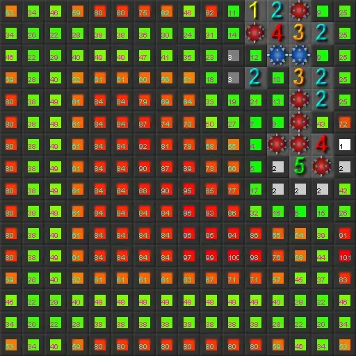

And this is the output of an actual score configuration. It is showing the rank of the possible moves, where 1 is the best rank and has been highlighted in white:
Example output of scoring approach

  • Using some tools, it is possible to check why a specific move was made and which scorers were mainly responsible for that move
  • Using tools, it is possible to create a map of the overall score/rank of possible moves (like the screenshot above)
