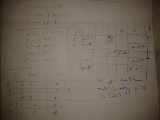

If you want to test the grammer is LL(1).
First if you have left recursion it must be solve it .
Then the new output you want to calculate the first and follow to draw the table .
Then check if you don't have multiple entry in the table so this grammer is LL(1) else is not LL(1). Note in your grammer may be have error in writting it. plz check it.
E→E+T∣T
T→T#F∣F
F→(E)∣i
