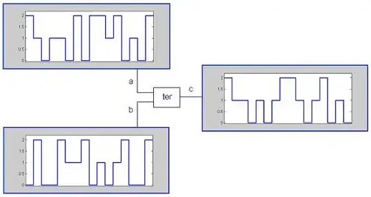

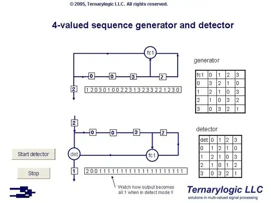

In a web book about multi value switches, peter lablans states that N.value transistor switches create truth tables, which are mostly useful for scrambling and descrambling data.
Recently quantum dots have been integrated into amorphous zinc oxide gates (zinc being a non oxidizing metal?!) To make silicon ready 3/4 state switches for current CPUs, and its promoted as a quantum interface, not as an efficient logic process.enter image description here https://lemmatalogic.com/multivaluedlogic/images/ enter image description here

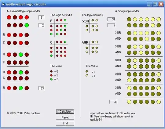

He has a vb program here https://lemmatalogic.com/multivaluedlogic/#scr
enter image description here]3
