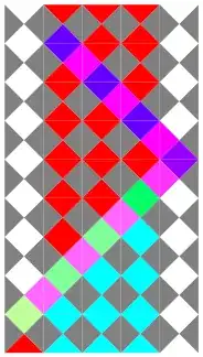

Update:
Image is that of a Wang tile that adds 1 to a binary: 111 + 1 = 1000 where 1 is red, 0 is cyan. Aiming to generate tiles like this from any Turing Machine. First row 111, last row 1000.
Wang Tile
