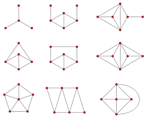

For example, a graph is a line graph if and only if it does not contain any of these 9 graphs below as a subgraph:
An alternative characterisation is that a graph is a line graph if and only if you can partition the graph into cliques such that every vertex belongs to exactly two cliques.
