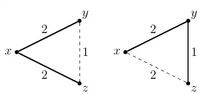

To see the difference you should try to construct a few examples to see what happens, That is really instructive. The simplest example that shows different behaviour is a triangle $x,y,z$ with edges $\{x,y\}$ and $\{x,z\}$ of length 2, while $\{y,z\}$ has length 1. Starting in $x$ Dijkstra will choose $\{x,y\}$ and $\{x,z\}$ (giving two paths of length 2) while Prim chooses $\{x,y\}$ and $\{y,z\}$ (giving spanning tree of weight 3).
trees: Dijkstra vs Kruskal
