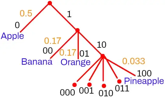

Is there any efficient way to encode words into bits, without having to draw the graphs, solely by only using a list of probabilities?
EXAMPLE
This list of words:
  • Pr('Apple') = 0.5.
  • Pr('Banana') = 0.17.
  • Pr('Orange') = 0.17.
  • Pr('Pineapple') = 0.033.
Will get assigned these bits: enter image description here
So this words list: Apple Banana Banana Pineapple ...
Becomes this bits list: 0 100 100 110100
Problem: I used a graph, and this is time consuming. So I'd like to know if there is any neat algorithm that lets me to encode the words into bits, directly based on the probabilities, without having to draw graphs 1st.

If you're allowed to reorder the symbols, then the answer is yes. We'll approach this in three stages.
