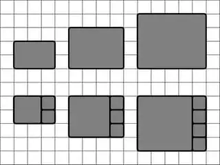

Top row: The almost-square-rectangles of widths $3$, $4$ and $5$. Bottom row: Are these miminum-square-partitions of their corresponding rectangles?
My question is now:
What is the minimum-square-partitioning of an almost-square-rectangle?
Can we prove ${\rm M{\small IN}S{\small QUARES}}(R_{w,h=w-1})=w$?

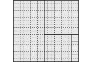

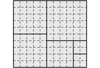

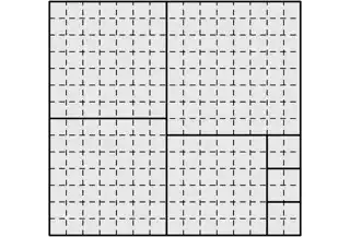

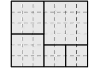

You can tile a $(4t+7) \times (4t+6)$ rectangle using only $t+5$ squares (for $t \geq 0$).
Tiling a 6 by 7 rectangleTiling a 10 by 11 rectangle Tiling a 14 by 15 rectangleTiling a 18 by 19 rectangle
