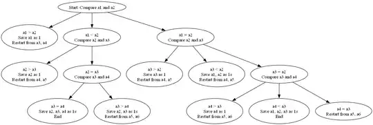

Start by splitting the 100 elements in 50 pairs of two, and use a comparison on each pair. If a comparison returns -1 or 1, then you've found one of the elements which is 1 (and the other one must be a 0).
Now there are two cases after these 50 comparisons: either we've found all three 1's, or we've found one 1, because the remaining two were part of the same pair. In the latter case we must find the pair which contains the last two 1's.
In this case there will be 49 pairs left (we can exclude the (0, 1) pair we identified earlier) one of which is the (1, 1) pair. We can find it by pairing the pairs, and doing one comparison each (for a total of 24 comparisons, leaving one pair out). This will identify which pair is the one with (1, 1), or if not, we know it must be the last pair.
This gives a total of 74 comparions. In fact, we could have saved one more comparison in the first step by stopping after 49 comparisons. If we have found two 1's in those first 49 comparisons we do one more to find the last 1 and we are done, and if we've found only one 1 it's useless to perform the comparison on the last pair, as it could only be (0, 0) or (1, 1), giving us no information.

  6. Fixing which index values to add after finding that the last two 1s are the last pair: You missed this completely. Inputs where the last two data values are 1s will get wrong results until this is fixed.
Responding to "Edit 3":
  1. excluded_indices is a good addition, but one of the update calls on it is wrong. The correct indices to exclude when you find a 1 in the first loop are always {i, i + 1}, because that is the pair that you compared regardless of which part of the pair is the 1.
  2. This one technically isn't wrong, as in it won't cause your code to produce incorrect results, but checking excluded_indices in the condition for comparing the final pair is pointless. The indices of the final pair cannot possibly be in excluded_indices at that point in the code, because the final pair hasn't been checked yet.
  3. You still haven't fixed issues 4, 5, and 6 from my previous edit. Those are for the sections of code that you labeled as step 2 and step 3.
