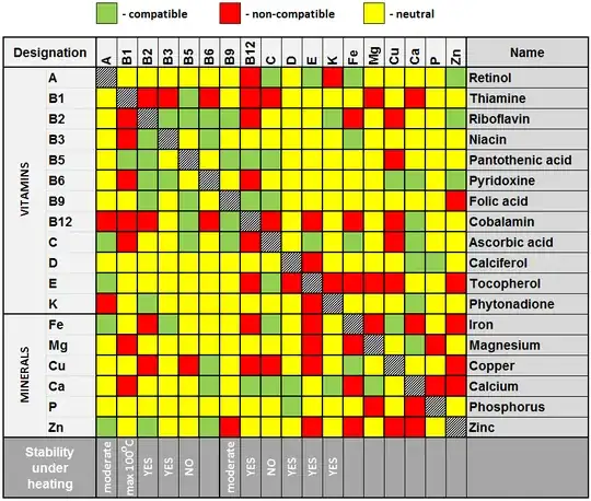

I am working on a problem that involves distributing a set of N supplements across a predefined number of meals (M) in a way that maximizes the total number of positive interactions and minimizes negative interactions between the supplements. Each interaction between the supplements is known beforehand (positive, neutral or negative: see the image below).
Supplements compatibility chart
I'm seeking advice on the mathematical formulation of this problem and potential algorithms or tools that could be used to solve it. Here's what I came up with:

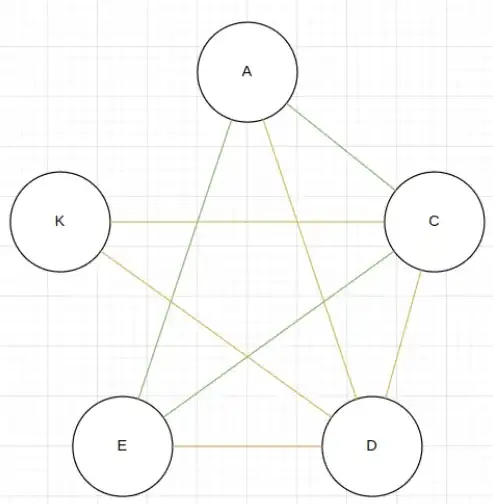

  • We can build a graph G from table of compatibility, with edges 1/0/-1 for positive, neutral and negative interactions correspondingly
  • Then we can remove -1 edges completely
  • Now we have modified graph G' with 0/1 edges only (see the image below)
Graph G' with 1/0 edges only
  • And we want to cover it with M cliques (bc clique in this graph will guarantee no 'bad' connections), finding a coverage with maximum number of +1 green edges
This method is not very good because:
  • it doesn't consider using -1 red edges at all while building meals
  • it has a very big time complexity (hours or days for 1 calculation on ~20 supplements)
I'm open for any suggestions. Maybe there are existing algorithms for solving this problem, or tools (like solvers)? Or is there a name for this problem I could search algorithms for?
