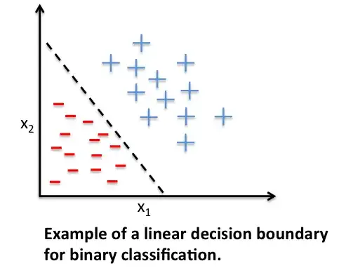

The first kind of artificial neural networks, the famous McCulloch-Pitts neurons, were linear, meaning that they could only solve linear decision problems (ie, datasets that could be linearly separable by drawing a line). Over time, this linear neural network model became known as the Perceptron or Adaline (depending on how you compute weights update).
Linear neural networks are just composed of a bipartite graph, where the left side nodes are the inputs and the right side nodes the output. Only the weights of the edges between these nodes are learnt (the nodes activation threshold can also be adjusted but this is rarely done).
Basic neural network such as Adaline or Perceptron (no hidden layer) Linear decision boundary

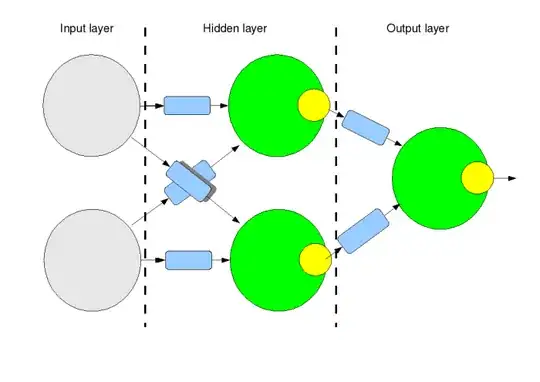

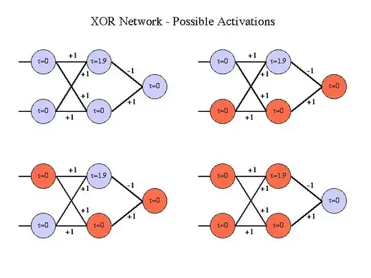

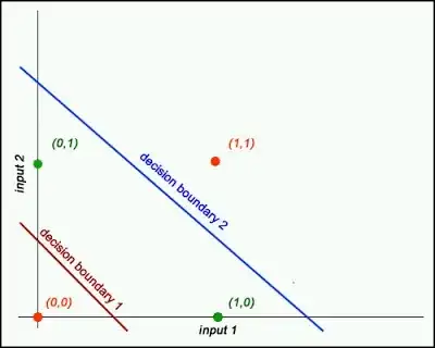

A big step was taken when shallow neural networks were invented: instead of having only a bipartite graph, we use a 3partite graph: the input "layer", the output "layer", and one "hidden layer" between them. Thank's to the hidden layer, the network can now take non-linear decisions, and solve problems such as the canonical XOR.
Xor neural network Xor neural network example activations paths Xor network decision boundary

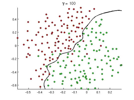

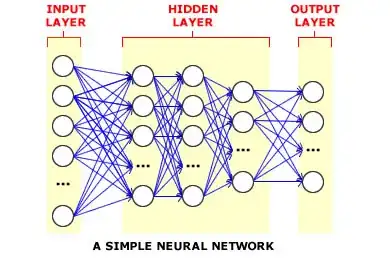

Note that the "shallow" term was coined retrospectively when deep neural network (also called n-layers neural networks) were invented. This is to oppose neural networks with only one hidden layer, with deep neural networks with n hidden layers. As you can guess, using more hidden layers allow to decide on more complex datasets since there are more layers to modulate the decision (ie, in other words you're increasing the dimensionality of your decision boundary, which can lead to overfitting).
N-layer neural network Complex non-linear decision boundary using a n-layer deep neural network

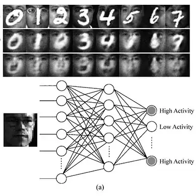

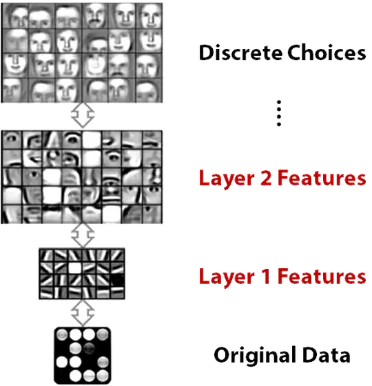

In fact, to neatly summarize, you can say that AutoEncoders are a simpler form of Deep Belief Network. Here is an example of a DBN trained to recognize faces but NOT numbers, the numbers are automatically faded away (this is the "fixing" effect of DBN):
Deep Belief Network example on face recognition
So in the end, DBN and DNN are not opposite: they are complementary. For example, you can imagine a system to recognize hand-written characters that will first feed a character's image to a DBN to make it more stereotypical and then feed the stereotyped image to a DNN that will then output which character the image represents.
