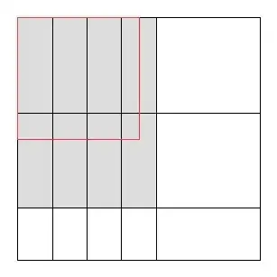

Next, we have a look at the lower bound. Let $W$ and $L$ be the side lengths of the original sheet of glass. Without loss of generality, we can assume that there exists a buyer $i$ such that $w_i \leq W$ and $l_i \leq L$. Otherwise, the original sheet would be unusable, no matter if we use guillotine cuts or general cuts. However, using guillotine cuts, we can always cut out at least one quarter of the original sheet by simply aligning the rectangles desired by buyer $i$, as shown in the following picture.
Notice that the red rectangle corresponds to one quarter of the whole sheet and is completely covered by the gray rectangles buyer $i$ desires. On the other hand, even if we use general cuts, we cannot use more than the whole sheet, which gives us a lower bound of $1/4$.
