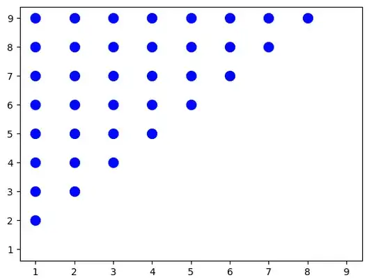

Triangle = isl.BasicSet("{S[i,j] : 0 < i < j <= 9}") plot_set_points(Triangle,color='blue')
Output
Consider the above nested loop, which exhibits Static Control Part (SCOP) characteristics, the iteration vectors we get are as follows:
{(1, 2),(1, 3),(1, 4),(1, 5),(1, 6),(1, 7),(1, 8),(1, 9),(2, 3),(2, 4),(2, 5),(2, 6),(2, 7),(2, 8),(2, 9),(3, 4),(3, 5),(3, 6),(3, 7),(3, 8),(3, 9),(4, 5),(4, 6),(4, 7),(4, 8),(4, 9),(5, 6),(5, 7),(5, 8),(5, 9),(6, 7),(6, 8),(6, 9),(7, 8),(7, 9),(8, 9)}.
These vectors correspond to the values of the i and j variables within the loop bounds.
And the vectors satisfy loop-bound conditions; 1<= i < 9 and i+1 <= j < 10
From loop bound condition we derive the Presburger formula; i >= 1 ∧ i < 9 ∧ j > i ∧ j <= 9
Thus, we can say the iteration vectors also satisfy the Presburger formula. As a result, this set of iteration vectors can be called a Presburger Set.
The Presburger formula and set can be expressed in set builder notation as; {S[i,j] : 0 < i < j <= 9}
This notation can be passed as an argument to isl.BasicSet, and we can visualize the iter domain derived from the set (refer to the output diagram above).
