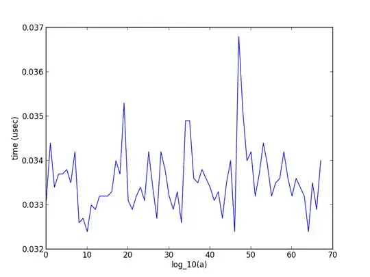

This is absolutely not a legit evaluation (not least because it's Python), but here's some numbers from running python -mtimeit "$a * $b" for $a in $10^{\{1,2,...,66\}}$ and $b = 2*$a. (I stopped at 66 because that's when Python syntax stops accepting integer literals and I'd have to slightly switch my evaluation code, so I didn't. :p)
Each number is the mean of 10,000,000 loops, where it takes the best time of 3 runs in each loop. I'd do error bars or something but that'd be more effort. :p In any case, it looks pretty constant to me, even out to $10^{50}$ -- slightly surprising, since $\log_{10}(\tt{sys.maxint})$ is 43, which reinforces my suspicion that maybe this evaluation is particularly bogus and I should do it in C.

However, you will notice the difference only for very large values of $M$, that cannot be stored in a single register, as you can see from Dougal's experiment.
