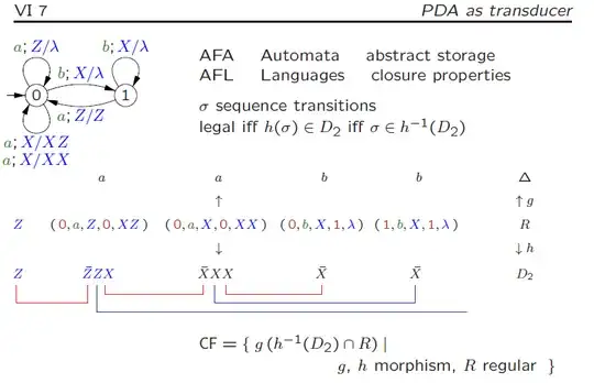

Basically the CST construction works to obtain such a result. The inverse homomorphism however can be used to code both input letters and pushdown symbols into two pairs of brackets. The context-free language is of the form $L = h( g^{-1} (D_2) \cap R)$.
PS. Below an old slide I have. (note. The roles of $g$ and $h$ are reversed.) It illustrates that we can see a PDA diagram as a finite state automaton, which defines regular sequences of instructions: the set $R$. Whether such a sequence is allowed as a computation has to be verified by checking that the pop and push instructions are legal. Legal sequences are Dyck sequences (with matching brackets). Thus we map the instructions to $D_2$ here using $h$. Finally the language of the PDA is the sequence of input letters, which is obtained from the instructions using the second morphism $g$.
