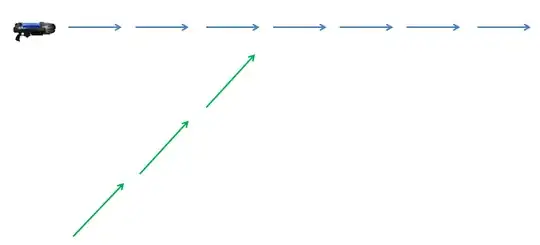

However, another ray may come from afar: enter image description here

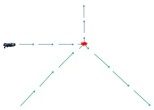

As everybody knows, plasma rays are deviated when they collide. In fact, they are always deviated 90°, away from the other ray:
Space is discreet (like a chess board). Each tile may contain either a plasma gun, a plasma ray or nothing. Rays can go either straight or diagonally. An important precision: rays are "instant", they do not take any time to propagate.

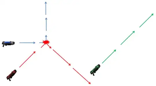

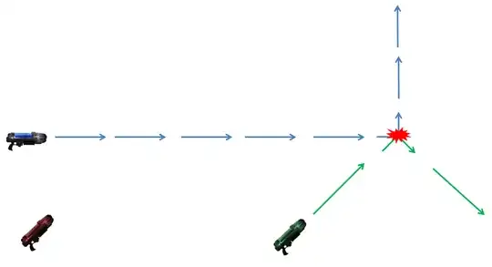

EDIT: Note that collisions can have cascading consequences. For example in this situation: enter image description here
If I fire the red plasma gun, This is what I should get:

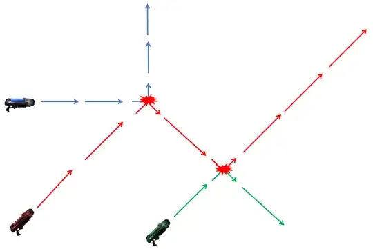

The green trajectory was affected by the new collision between red and blue. New collisions can also appear:

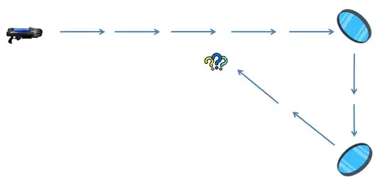

Last but not least, paradoxes can appear:
