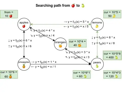

Suppose there are traders who can exchange one good for another. Each trader $i$ defines two functions $y = f_{i1}(x)$ and $x = f_{i2}(y)$, with which we can determine how much of $y$ or $x$ we can receive after exchanging with this trader. For example, trader 1 can exchange apples for lemons with the formula:
$$numberOfLemons = 5 * numberOfApples$$
and vice versa:
$$numberOfApples = 0.2 * numberOfLemons$$
Suppose I have some amount of good A, and I want to receive the most possible amount of good B with my current amount. For example, I want to receive the most amount of pears for my 10 apples.
See the picture:
Exchange apples for pears.
In the picture, the most amount of pears that I could receive for 10 apples is equal to 400 pears.
