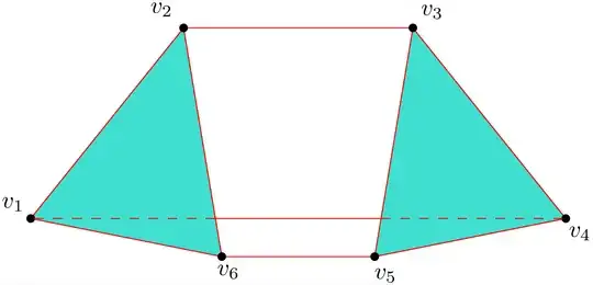

Consider the following full hypergraph $H$ (or abstract simplicial complex) of dimension $2$, represented as a simplicial complex (nodes are in black, $2$-edges in red, $3$-edges are turqoise triangles): enter image description here
(or, algebraically: $E_0 = \{v_1,v_2,v_3,v_4,v_5, v_6\}$, $E_1=\{(v_1,v_2), (v_2,v_3), (v_3,v_4), (v_4,v_5), (v_5,v_6), (v_1,v_6), (v_1,v_4), (v_2,v_6), (v_3,v_5)\}$, $E_2 =\{(v_1,v_2,v_6),(v_3,v_4,v_5)\}$ )
$H$ is regular according to the first definition, since each vertex belongs to 3 $2$-edges and 1 triangle. However, $H$ is not regular according tot the second definition, because e.g. $(v_1,v_2)$ is contained in 1 triangle while $(v_2,v_3)$ is contained in 0 triangles.
This means the "other direction" does not hold for dimensions $2$ and higher, so the two properties are not equivalent. (Of course, the two definitions are trivially equivalent for dimension $1$)
As for whether the second property implies the first, your proof (which seems to be for dimension $2$) looks correct to me. The step of going from $2$-edges to $3$-edges can be generalized into $i$-edges to $(i+1)$-edges, after the proof follows by induction. So, it seems the second property is stronger than the first.
