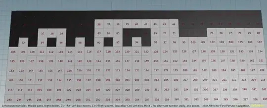

I'm working on the implementation of a cantor set on a 2-dimensional plane. It looks like this. Honestly, There is the obvious algorithm for the cantor set, but it includes a recursive method call. Unfortunately, My environment(Houdini vex) does not support recursive function calls, so I have to design the algorithm without using recursion.
  1. Is it possible to represent a cantor set without recursion?
  2. How can I represent the recursive thing in the algorithm without recursion?
Cantor set implementation on a 2-dimensional grid

Yes. It can be expressed without recursion, as long as you have loops and data structures. Any recursive algorithm can be converted to a non-recursive iterative algorithm, by introducing an explicit stack. See, e.g., Iteration can replace Recursion?, Iterative and/or tail-recursive implementations of merge sort?, Do we need recursion in programming language to solve any problem?.
