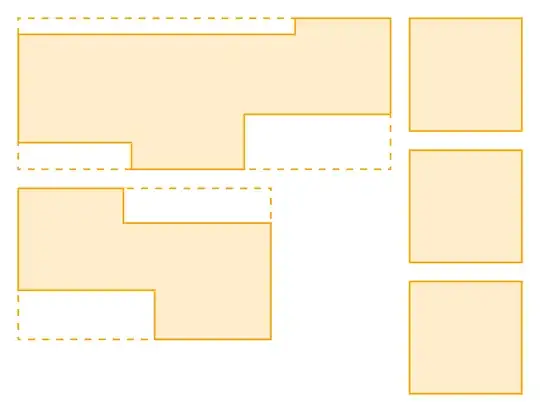

Input: n “Utah-like”, fixed-orientation polygons. n is in the range 1-20. The figures are not shaped to align perfectly with each other. Example figure set:

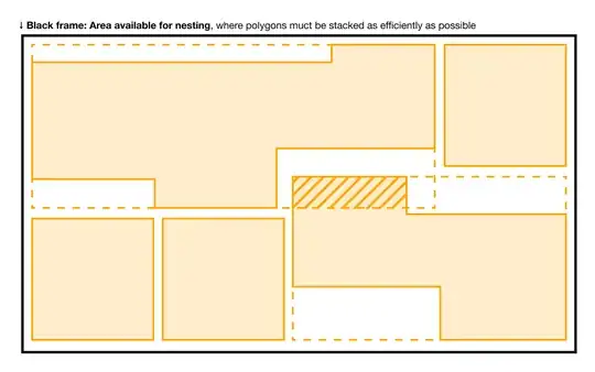

Desired output: A fixed-orientation nesting for a scaleable area with predefined proportions. The scaleable area should be scaled to fit the nested figures as snugly as possible, like so:
Note the area where the figures' rectangular boundaries overlap, preventing this from being a more trivial rectangle-packing problem.
