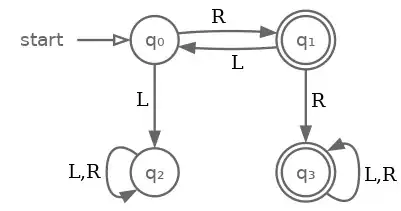

Building on Daniel Martin's answer, we could try to construct a language that accepts positive rationals smaller (or greater) than a specific quadratic irrational number. At first, this might seem impossible since quadratic irrationals lack periodicity in their expansions. However, the trick is to encode them as periodic (infinite) words, which is straightforward when using their continued fraction expansions.
For added flair, we could use the golden ratio to define our language. Behind the scenes, the golden ratio is particularly simple, as its continued fraction expansion consists entirely of repeating coefficients of 1.
The challenge, then, is to have the user input a continued fraction representation without making it too obvious. A clever way to obscure this is by asking the user to provide a sequence of left/right moves on the Stern-Brocot tree. These moves are directly tied to the continued fraction expansion of the given rational number.
Our final language is thus: the set of all positive rationals, encoded as left/right moves on the Stern-Brocot tree, which are smaller (or greater) than the golden ratio. (Of course, any quadratic number can be used instead of φ as such numbers have a periodic continued fraction expansion).
Building an actual DFA for that would require some care and attention to detail but would be perfectly achievable.
In the specific case of φ, the DFA should be of a very reasonable size. The language of rationals greater than φ would probably look like: the set of words where an initial prefix RLRLRLRLRLR is first broken after an R not followed with a L (either followed with another R or at the very end of the word).
Edit. Although not much time was spent on it and no warranty is provided, the DFA should closely resemble the following.
