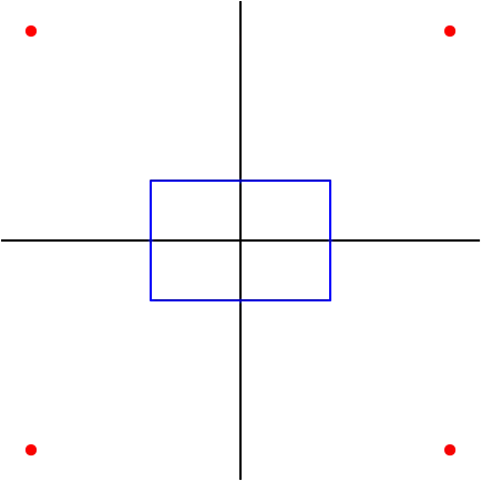

Consider the example below where $n=4$. The points are the red dots, the median lines are the black lines, and the query rectangle is the blue rectangle. Does this show the lower bound, or do we need a more general construction since for $n=4$ we have $\log_2(n) = \sqrt n$?

No. To show a $\Omega(\sqrt{n})$ lower bound, it's not enough to show a lower bound for the single value $n=4$. I suggest you refer to the definition of big-Omega notation: https://en.wikipedia.org/wiki/Big_O_notation#The_Knuth_definition, https://en.wikipedia.org/wiki/Big_O_notation#Formal_definition, How does one know which notation of time complexity analysis to use?.
