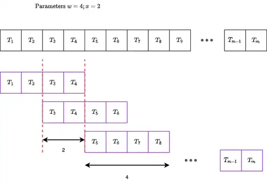

Suppose we have a sequence of $m$ tokens $(T_1, T_2, \ldots, T_m)$. We can split this sequence considering two parameters $w$ (which is the width of the window) and $x$ which is the overlap between windows. This is depicted in the following figure:
Token sequence and split

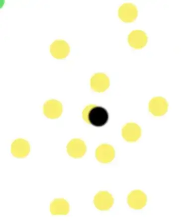

This procedure is performed for all windows of a given sequence, based on parameters $w$ and $x$. In the end, I will have a cluster of points with a centroid:
Centroid
