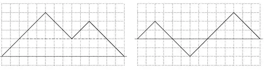

We want to generate strings of the form $1^n 0^m 1^k 0^p$ with the same number of $0$ and $1$. This language can be generated by distinguishing two cases.
The first approach is to draw a diagram what happens if we keep counting the difference between the numbers of $0$ and $1$. This difference between the cases is whether the count drops below zero or not.
The two examples correspond to $1^5 0^3 1^2 0^4 = 1^2\; (1^3 0^3) \; (1^2 0^2) \; 0^2$ and $1^2 0^4 1^5 0^3 = (1^2 0^2) (0^2 1^2) (1^3 0^3) $.
The structure of the diagram indicates which pairs of $0$ and $1$ can be generated together by the CFG.
Observe that such a diagram more or less represents how a push-down automaton would keep track of the string.
