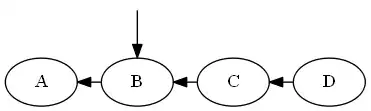

Step 4
Insert $B$, $A < B < C$.
List:
list step 4
Tree:
tree step 4
No rotations necessary.

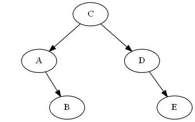

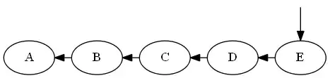

Step 5
Insert $E$, $D < E < \emptyset$
List:
list step 5
Tree:
tree step 5

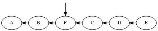

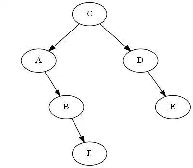

Insert $F$, $B < F < C$
We just put it right "after" $B$ in the tree, in this case by simply attaching it to $B$'s right; thus $F$ is now right after $B$ in the in-order traversal of the tree.
List:
list step 6
Tree:

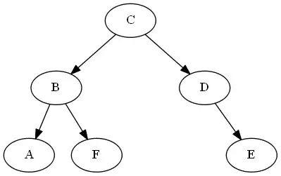

tree step 6 before rotation
AVL rotation:
tree step 6 after rotation
