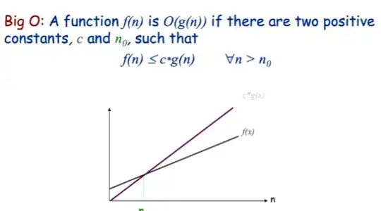

My professor recently brushed over the formal definition of Big O:
Big O definition

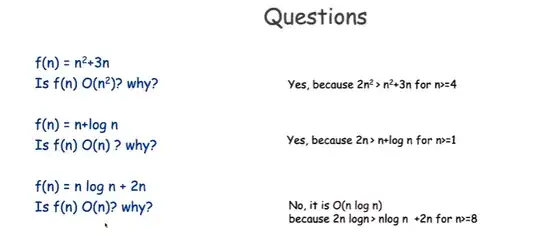

To be completely honest even after him explaining it to a few different students we all seem to still not understand it at its core. The problems in comprehension mostly occurred with the following examples we went through:

When you multiply a function's highest term by a constant, you get a new function that eventually surpasses the initial function at a given n. He called this n a "witness" to the function O(g(n))
How is this c term created/found? He mentioned bounds a couple of times but didn't really specify what bounds signify or how to find them/use them.
I think I just need a more solid foundation of the formal definition and how these examples back up the definition.
Answer is individual to each example. Let's take Your first one $f(n)=n^2+3n$ and $g(n)=n^2$. We need constants to satisfy inequality $$n^2+3n \lt c \cdot n^2$$ simplification gives $n \gt \frac{3}{c-1}$. I hope you easily found infinity couples of $n_0,c$ for which inequality is true.
Let me, also, help you with 3'd example assuming, that base of $\log$ is more $1$. Proving, that some function is $O(n\log n)$ doesn't mean, that it is not in $O(n)$. More: we have $O(n) \subset O(n\log n)$, so, each function from $O(n)$ is also in $O(n\log n)$.
To prove directly, that some function is not in some big-$O$, you need negation of definition $f(n)\in O(g(n)),n\to\infty$:
$$\forall c >0, \forall n_0\in\mathbb{N}, \exists n>n_0, f(n)>c\cdot g(n) $$
Taking now $f(n)=n\log n+2n$ and $g(n)=n$ we need to prove $n\log n+2n>c\cdot n$. After simplification we obtain $\log n > c-2$. This inequality, in required conditions, comes from $\lim\log n=+\infty$.

Look no further than the picture you attached that say
$f(n)$ is $O(g(n))$ if there exist two positive constants $c$ and $n_0$ such that $f(n) \leq c \cdot g(n)$ for all $n > n_0$.
That's the full formal definition and foundation for the O notation.
Sit down and prove that $n^2$ is not $O(n)$.
