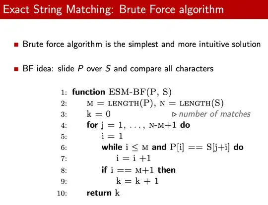

In case I got typos I will add the original from the slides to exclude that I just wrote it down wrong for myself:
ilam engl
  • 151
As rici pointed out the bug-free pseudo code is indeed:
1 ESM-BF(P, S)
2   m = length(P), n = length(S)
3   k = 0    # number of matches
4   for j=0,...,n-m do
5      i=1
6      while i ≤ m and P[i] == S[j+i] do
7         i = i +1
8      if i == m+1 then
9         k=k+1
10   return k
ilam engl
  • 151
