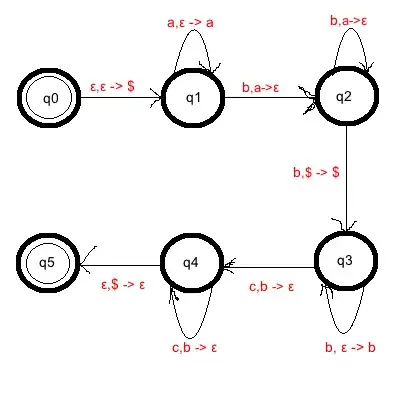

For the first one, $$L_1 = \{a^i,b^{i+j}c^j \mid i,j \geq 0 \} $$
Here's an rough idea of the algorithm:
  • read off the all '$a$'s and push $a$ into the stack
  • upon seeing a '$b$', pop the '$a$'s till the stack is empty
  • then again as long as reading '$b$'s keep pushing $b$ into the stack
  • on seeing a $c$, start popping the stack until empty.
