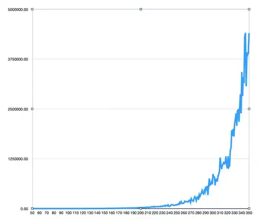

Theoretically, we don't know how hard k-SAT is; P ?= NP remains an open question. Empirically, random $k$-SAT at the critical clause/variable ratio for each $k$ seems to require exponentially more effort as the number of variables increases. As an exercise I ran glucose on thousands of random 3-SAT instances with a 4.26 clauses/variables ratio, averaged the results for each instance size and graphed the results, number of variables vs. decisions.
As expected, the trend is exponential, though the number of decisions needed as problem size increases is nowhere near the naive $O(2^n)$ expectation or the proven $O(1.321^n)$ upper bound for a particular randomized search algorithm.
