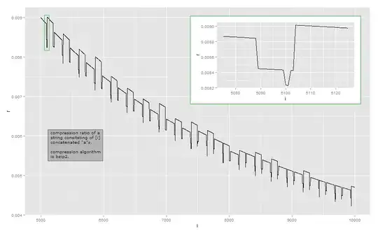

library(ggplot2)
compress <- function(str) {
  length(memCompress(paste(rep("a", str), collapse=""), type="bzip2"))
  / nchar(paste(rep("a", str), collapse=""))
cr <- data.frame(i = 1:10000, r = sapply(1:10000, compress))
ggplot(cr[cr$i>=5000 & cr$i<=10000,], aes(x=i, y=r)) + geom_line()
The compression ratio starts out at 37 for "a" and hits the break-even at 39 "a"s (compression ratio = 1). The chart starts out pretty smooth and gets edgy suddenly for 98 "a"s and from there at increasingly small intervals.
The local lows and smooth sections seem also quite erratic and random. Can somebody explain to me why bzip2 shows this behaviour in this example?

Suppose a simple compression algorithm that represents a run of a by storing $(\text{header}, \mathtt{\text{"a"}}, n)$, i.e. some fixed header, the string a, and the number of repetitions $n$. This is a run-length encoding. Then the length of the compressed text would be close to $a + \lg n$ bits for some constants $a$. The corresponding compression ratio would be $\dfrac{a + \lg(n)}{n}$. This is roughly the shape of the curve as seen from a distance, if you neglect the local ups and downs. Asymptotically, the compression ratio is $\Theta(\lg(n)^p/n)$ with $p \ge 1$ (I haven't worked it out but I suspect there are other factors at play which make the size of the output superlinear in the length of the input string).
$\lg n$ bits aren't an integer number of bits, let alone bytes: the size of $n$ has to be at a minimum rounded up to an integer number of bytes. This explains a first threshold effect: for this simple compression algorithm, you would observe that the length of the output is $a$ when $n$ is sufficiently small, then $a+1$, then $a+2$, etc. The compression ratio therefore isn't a smooth curve but jumps from $\dfrac{a}{n}$ to $\dfrac{a+1}{n}$, then $\dfrac{a+2}{n}$, etc. This effect is barely visible in the realignment after jumps (but there are other effects at play which make the jumps different).

Bzip2 is far more complex that a simple run-length encoding. It works in a series of steps, and the first step is a run-length encoding step, but with a fixed size limit. The first step works as follows: if a byte is repeated at least 4 times, then replace the bytes after the 4th by a byte indicating the repeat count of the erased bytes. For example, aaaaaaa is transformed to aaaa\d{3} (where \d{003} is the character with byte value 3); aaaa is transformed to aaaa\d{0}, and so on. Since there are only 256 distinct byte values, only sequences where the byte is repeated up to 259 times can be encoded this way; if there are more, a fresh sequence starts. Furthermore, the reference implementation stops at a repeat count of 252, which encodes a string of 256 bytes.
This step explains the first threshold and the threshold at 258: $\mathtt{a}^n$ compresses to 37 bytes for $1 \le n \le 3$ and to up to 39 bytes for $4 \le n \le 258$. The introduction of the repeat count results in 2 more bytes in the output of the subsequent steps, and that extra byte is able to represent all repeat counts up to 258. After 258 bytes, there is a second RLE string. There is a third one at 514 bytes, a fourth at 769 bytes, and so on. Extra RLE strings after the second one don't cost much if at all because that sequence aaaa\d{252} (assuming that \d{252} is the repeat count, I haven't checked) is itself repeated and therefore compressed by subsequent steps.
Why are the thresholds at 258, 516, 769, (none at 1024), 1279 rather than exact multiples of 256? I suspect it's because the Burrows-Wheeler transform followed by a move-to-front can transform something like aaaa\374aa (output of step 1 for $n=258$) by moving the a's together so that they can be encoded together, but I haven't checked.
The reduction in length at $n=100$ is interesting. For the input $\mathtt{a}^{101}$, the first RLE step produces aaaa\d{97} — but the byte value of a is 97, so this is aaaaa which has better potential for compression by subsequent steps. I suspect that the shrinking effect not only for $n=101$ but also for surrounding values is due to the delta encoding step which makes it easier to store bytes with nearby values. If you change a to A (65), you'll notice that the shorter output happens for $68 \le n \le 83$.
My analysis of this example is far from exhaustive. To understand other effects, you would have to study the other steps of the transformation: I mostly stopped after step 1 of 9. I hope this gives you an idea of why compression ratios get a little choppy and don't vary monotonically. If you really want to figure out every detail, I recommend taking an existing implementation and observing it with a debugger.
