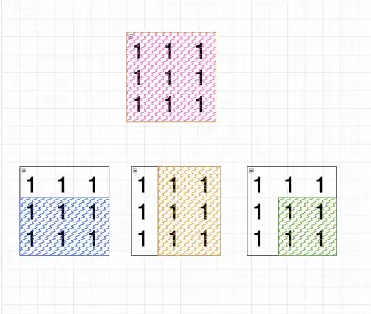

A problem is called solvable by Dynamic Programming if its solution can be calculated by solving its sub-problems.
Let's see how the current state of the given problem depends on its previous states (aka sub-problems).
Let the answer to the block in colour C be denoted by Ans(C).
We can clearly see that,
Ans(PINK) = 1 + Ans(BLUE) + Ans(ORANGE) - Ans(GREEN)
Note: we are subtracting the GREEN block because it was added twice (once in ORANGE and once in BLUE).
Mathematically speaking, if Ans(i,j) = answer to the block starting from (i,j) and ending at (n,m).
Ans(i,j) = 1 + Ans(i+1,j) + Ans(i,j+1) - Ans(i+1,j+1) This is known as the Dynamic Programming transition.
The base cases are self-explanatory :)
