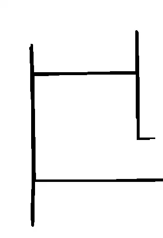

What I need to do is go from a binary image like this:

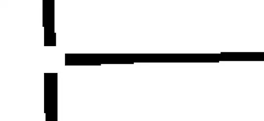

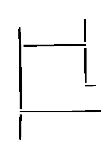

to a segmented structure like this:
because I have a program that operates on those separated line contours after. As you see, those contours are not perfect, they might be slightly bent but where they meet it's always pretty much orthogonal, there are no 45 degree lines. The lines are between 3 and 20 pixels wide. The whole image is sometimes slightly rotated (less that 10 degrees) but if you find a solution that only works without rotation I could look into de-rotating stuff before. The inserted gap may be of any width (preferably 1px or 2px) as long as it entirely separates one line from another.
I thought one could do something like on page 15 of this paper (the description of what they do is on page 13). Essentially this would come down to finding one marker per line segment and then watershed, but I have no idea how to find that marker.

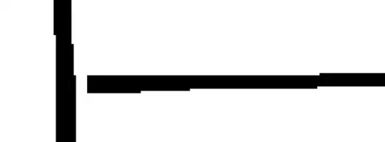

On any point of line intersection, this
is good, as well as this:

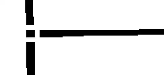

If easier to achieve,
this:
is acceptable too, although not preferred.

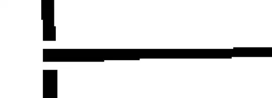

What's not ok is this:
This is not only true for three-line t-sections but also two-line corner connections (= it doesn't matter which of the two lines meeting gets shortened).
