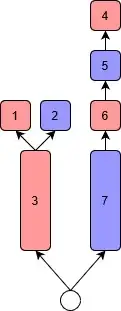

Another example: Consider the dependency tree below. $a \rightarrow b$ indicates "$a$ depends on $b$". The length of a block indicates the time it takes to complete (1 or 3 in this case). There are two resources/channels: red and blue.
dependency tree

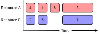

An example solution might look like this:
This shows that a greedy approach (like scheduling (1) and (2) simultaneously) is not sufficient -- you have to look ahead to minimize waiting for resources.
