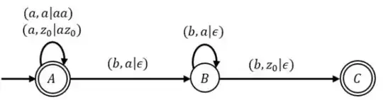

DPDAI would approach this question in this way, (k) in $\mathrm{LL}(k)$ means the number of lookaheads. The grammar of $\mathrm{L}$ here possess non-determinism. For example, if you can only see aaaa then by just looking at the first k symbols, you can't make the decision whether it is aaaa or aaaabbbb.
No matter how large the value of k is, there will always be some string which has the number of a's larger than the lookahead, for which we couldn't decide what string it is.
In short, here $\mathrm{LL}(k)$ cannot conclusively distinguish that whether the string is from $ a^n$ or from $ a^n b^n $.
Another reason that you can give is that the language here is a union of two languages which have common prefix. Hence the $\mathrm{LL}(k)$ cannot parse it using any value of lookahead k.
I agree that a language is $\mathrm{LL}(k)$ if there is an $\mathrm{LL}(k)$ grammar which recognizes the language.
But the language can also be $\mathrm{LL}(k)$ and has non-$\mathrm{LL}(k)$ grammars which recognize the language. Hence, If a language is $\mathrm{LL}(k)$, it does not mean that it has $\mathrm{LL}(k)$ grammar.
To understand more clearly why the language here is not LL(k),you can have a read of this LL(k) languages are closed under union with finite languages.
