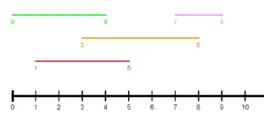

On a infinite 1-dimensional number line, we have N ranges specified by two distinct integers A and B, such that all A and B are unique. Each pair of integers then represents the starting and ending points of a range on the number line. How many distinct pairs of ranges intersect?
^^ In this example, 4 distinct pairs of segments intersect.
Obviously, there is a O(N^2) brute-force solution: just test all possible pairs in O(1) time each. However, I also thought of a O(NlogN) sweep-line algorithm: treat every A as a "segment start event" and every B as a "segment end event". Then, keep a variable curr_in_range (originally 0) that stores the current number of segments that we currently see, and then iterate through the events in sorted order of their positions on the number line. Every time we add another segment, add curr_in_range to the answer (because this new segment will intersect with every other segment that we can see) and increment it as well. Every time we remove a segment, decrement curr_in_range. In the end, this gets us the correct answer.

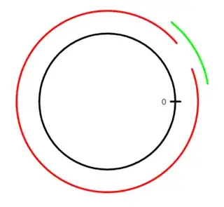

However, after extensive analysis, I found why this approach doesn't work. This approach won't work because it overcounts some of the intersections, as sometimes two sectors can intersect in 2 places. This is where I'm stuck.
^^ Our sweep-line algorithm will count 2 distinct pairs that intersect, when there is actually only 1.

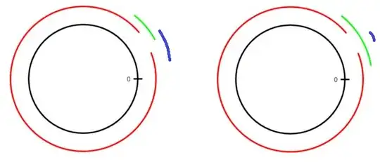

Not a solution, just an illustration of what I see as the core difficulty:
Left: 3 intersections. Right: 2 intersections.
The instance on the left has 3 intersections, the one on the right only 2, but there is no way to distinguish the instances just by counting numbers of "begin segment" and "end segment" events within a given interval. (Inside the gap left by the red interval, the event sequence is "begin", "end" in both cases.)
This implies that a sweep-line approach needs to track more information about each active segment -- probably their identities, which suggests to me that no fast algorithm will be possible, though that's just a feeling.
