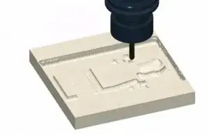

By representation, I refer to that beige raw piece in the image: how to efficiently represent it in memory, but more important, how to efficiently calculate it new shape, every few milliseconds, based on the path and shape of the tool bit.
