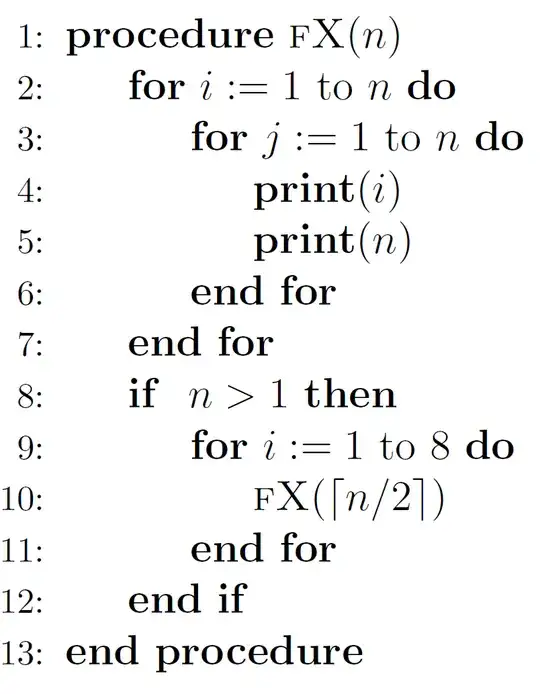

I wanted to calculate the complexity of this pseudocode. In my knowledge, it is $n^2$ because the last loop only runs 8 times. I wrote a program to test it tends to run 8^logn (approximately). can you help me to find the correct answer_
1: procedure f(n)
2: for i := 1 to n do
3: for j := 1 to n do
4: print(i)
5: print(n)
6: end for
7: end for
8: if n > 1 then
9: for i := 1 to 8 do
10: f([n/2])
11: end for
12: end if
13: end procedure
