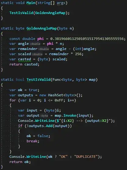

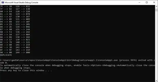

My first (bad) attempt in C# was to use a golden ratio and travel around a circle, since mathematically this is guaranteed to give a unique angle every time. In theory (phi * n) mod 360 is sort of random looking and unique. Sadly this only works if you have infinite precision and not at all when you have discrete buckets for the output, so this idea didn't really work out, even when N = 255:
Code
Result
