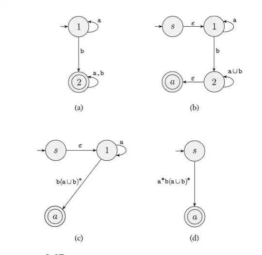

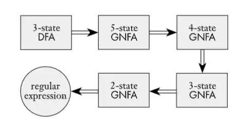

Now the last step is to convert the GNFA to a RE.
After the conversion of DFA to a GNFA with a special form, we know that each arrow of GNFA can contain a regular expression, and at this point, the last step consists of the following passages:
  • Remove the intermediate step with an intermedia regular expression, until to remove all intermediate state. The result that we can have is (InitState)--- RE---->(FinalState), and the regular expression of the transition from InitState to FinalState is the regular expression accepted from the previous DFA.
The passages can be express with the Figure below:
A complete example, that can help you to understand the process described inside this answer.
